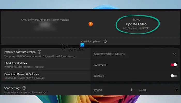

AMD Software comes pre-installed on the computers with AMD hardware. It helps users keep all necessary drivers, including chipset drivers, graphics drivers, etc., up to date. AMD releases updates for the AMD Software from time to time. The software reflects all these updates so that you can install them. However, some users encountered the Update Failed error while installing updates on the AMD Software. This article lists some fixes for the AMD Software Update Failed error on Windows 11.
To fix the AMD Software Update Failed error on your Windows 11/10 computer, use the following suggestions:

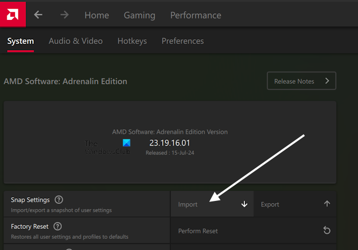

Factory reset the AMD Software if the error still occurs. First, backup all AMD Software settings by following the instructions provided below:
- Open AMD Software.
- Click on the gear-shaped icon on the top right side to open its Settings.
- Click on the Export button next to the Snap Settings option.
- Save the zip file.
You can import these settings later by using the Import option in the AMD Settings. Now, factory reset the AMD Software.

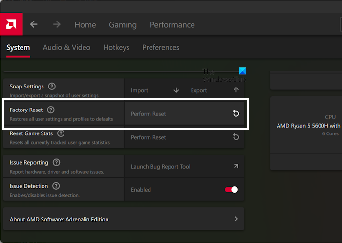

- Open the AMD Software.
- Open its settings.
- Click on the Perform Reset button next to the Factory Reset option.
- You will see a warning message. Click Proceed.
Now, see if you can download the update.
