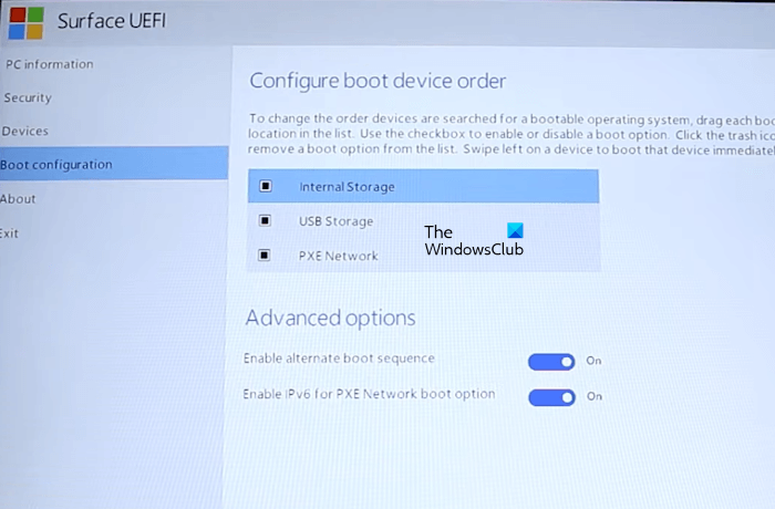

2] Check the Boot Configuration
The next step is to check the boot configuration. Check if the boot configuration settings selects the correct disk as a boot device. Enter the UEFI and select the Boot Configuration option from the left side. Now, check which device is selected as the boot device. If it is not the correct boot device, select the right one and drag it to the top.
Select Exit from the left and tap on the Restart option. See if the error occurs this time.

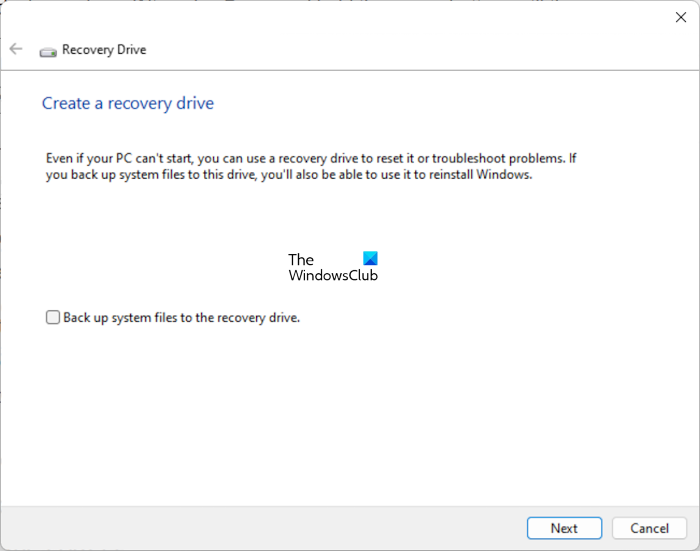

Download the recovery image for your Surface device on a working computer from the official Microsoft website. To download the correct recovery image, you need to enter your Surface laptop model number. Once the Recovery image is downloaded on the computer, connect a USB flash drive to the computer. Now, click on Windows Search and type Recovery Drive. Select the Recovery Drive from the search results. Click Yes in the UAC prompt.
The Recovery Drive tool will launch. This tool will make the USB flash drive a recovery flash drive for the Surface device. In the Recovery Drive tool, uncheck the Back up system files to the recovery drive checkbox and click Next. Now, select the USB flash drive and click Next. Click Create. This action will format your USB flash drive. Therefore, backup your data from the USB flash drive before performing this action.
Now, open the folder containing the recovery image you downloaded from the Microsoft website. Copy and paste all the data inside that folder into the USB flash drive. If prompted to replace the existing files, click Yes.

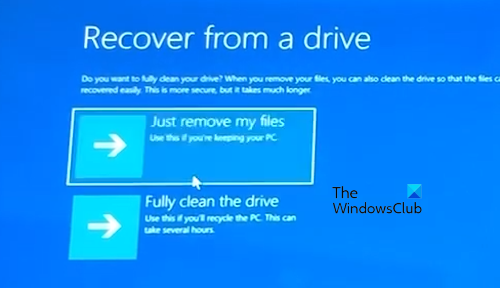

Go to your faulty Surface device and connect the USB flash drive to its USB port. Press and hold the Volume down button and then press the power button for once. Keep holding the Volume Down button until you see the Windows logo and spinning dots on the screen. Select the keyboard layout (if prompted). Now, select Troubleshoot > Recover from a drive > Just remove my files. After that, click Recover. Your Surface device will restart to start the recovery process. When you are done, set up your PC by following the on-screen instructions.
