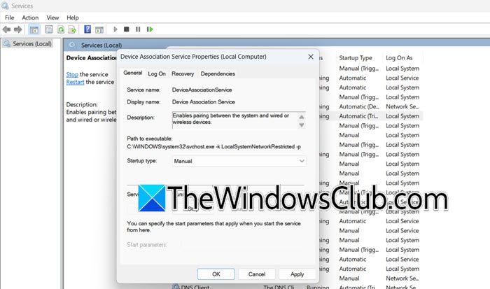

1] Restart the Device Association Service
The first thing we are going to do is restart the Device Association Service, the service responsible for managing device associations and ensuring that the connected devices are communicating effectively. To do the same, follow the steps mentioned below:
- Click Win + I to open the Run dialog box, type in services.msc, and hit OK.
- Scroll down, look for Device Association Service, and double-click on it.
- In the Startup Type scroll down the menu, select the Manual option, and select the Stop.
- Once it is stopped, click on the Start option.
- Apply the changes, click OK, and restart the PC.

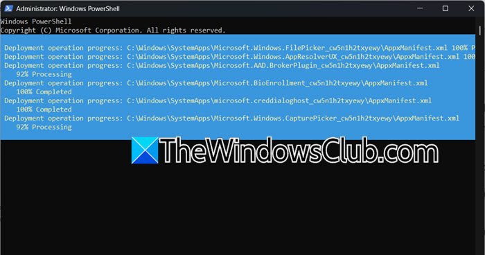

2] Re-register the Windows component
Endpoint discovery failures often happen due to registry issues, outdated configurations, or broken dependencies. Re-registering the Windows component resets the associated system configurations and eliminates potential corruption. To do the same, run PowerShell with admin rights, and run the following command:
Get-AppxPackage -AllUsers | Foreach {Add-AppxPackage -DisableDevelopmentMode -Register "$($_.InstallLocation)\AppxManifest.xml"}
Restart the PC to ensure that all changes are applied correctly and that any ongoing updates or configurations are completed.

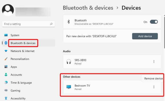

3] Clear Device pairing data
In this solution, we are going to clear Device pairing data to ensure a fresh start for the pairing process. These steps also force the devices to rediscover and establish a new clean connection with the endpoint. Here’s how to do the same:
- Click Win + I to open Settings, and click on Bluetooth and devices.
- Navigate to the Devices section, find and click on the Bluetooth device.
- Select the Remove device option, confirm the removal when prompted, and restart the devices to ensure the changes are applied.
After the PC boots up, navigate to Settings, and repair the device again.
