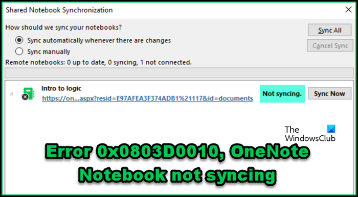

You may have encountered an issue where the OneNote Notebook is not syncing and gives the error 0x0803D0010. The error arises when the syncing process fails to initialize or finalize, resulting in disrupted data transfer to OneDrive cloud storage. In this post, we will discuss this issue and see what we can do to resolve this issue.
Fix Error 0x0803D0010, OneNote Notebook not syncing
If you encountered Error 0x0803D0010 and the OneNote Notebook is not syncing, follow the solutions mentioned below.

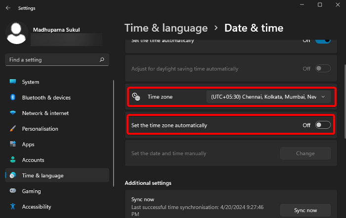

3] Set the correct time zone
If your time zone and time are set incorrectly, OneNote Notebook will not sync as it will fail to connect to the server. To rectify this issue, all we have to do is set the time zone and time correctly. Follow the steps mentioned below to do the same.
- Open Settings.
- Go to Time & language > Date & time.
- Now, check the Time zone and change it if it’s incorrect if the Set time zone automatically is greyed out or disabled.
- Then, enable Set time automatically.

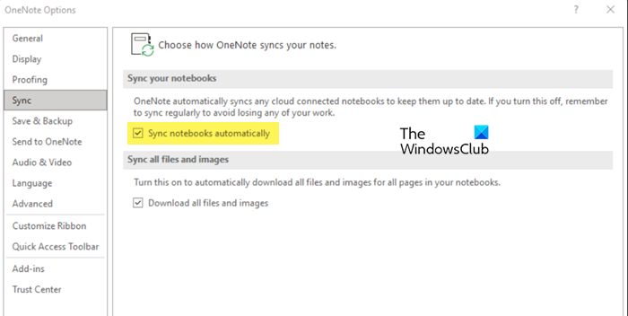

4] Restart the automatic sync option
Next, we will try a workaround by turning off the automatic sync feature, rebooting the OneNote app, and then turning it back on. In case the issue is a result of a glitch, restarting will do the job. Follow the steps mentioned below to do the same.
- Open OneNote.
- Then, click on File > Options.
- Go to the Sync tab and then turn off Sync notebooks automatically.
- Open the Task Manager, look for “OneNote”, right-click on it, and select End Task.
- Now, start OneNote again.
- Go ahead and turn on the Sync notebooks automatically option.
Finally, see if the issue is resolved.

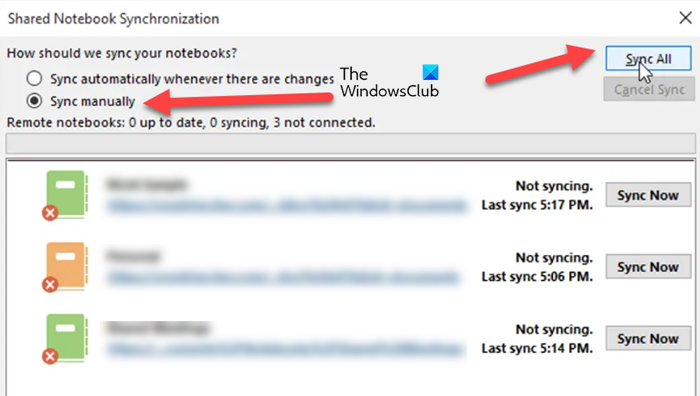

5] Sync notebooks manually
If you encounter an issue when syncing automatically, try doing it manually. Syncing all the unsynced items manually can also make automatic syncing work. To do so, follow the steps mentioned below.
- In OneNote, go to File > Info.
- Click on View Sync Status.
- You will see all the notebooks that are not synced, so, click on Sync manually, and then click on Sync All.
Please wait for a few minutes as it syncs. Finally, check if the issue is resolved.
