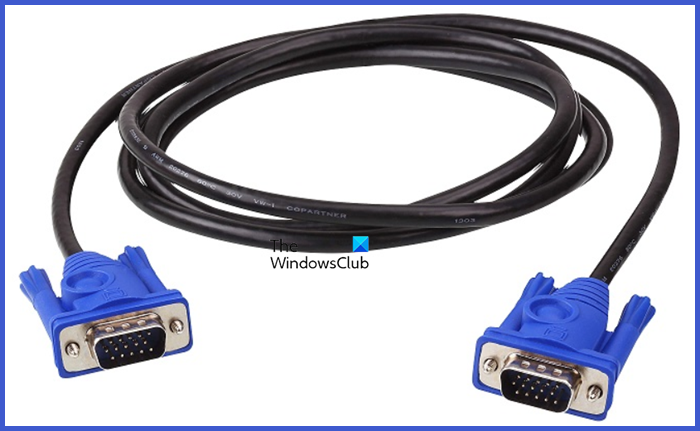

2] Replace the VGA Cable
Next, we urge you to replace the VGA Cable connecting your monitor to the CPU. Since these are not expensive, you can replace them and see if there is any problem with them. If replacing the cable does not help, we will move on to the next solution.

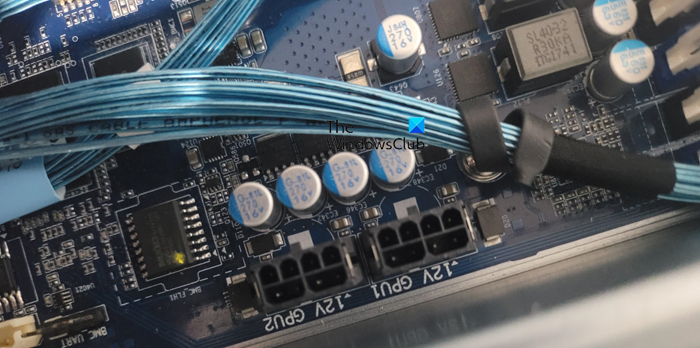

3] Disconnect and reconnect the GPU Power Cable
There are two cables (or one in some cases) at the back of your GPU. You need to unplug them from the motherboard and then plug them back in. For some, the simple act of disconnecting and reconnecting the GPU Power cable worked. If this doesn’t work for you, replace the cable and see if that helps.
