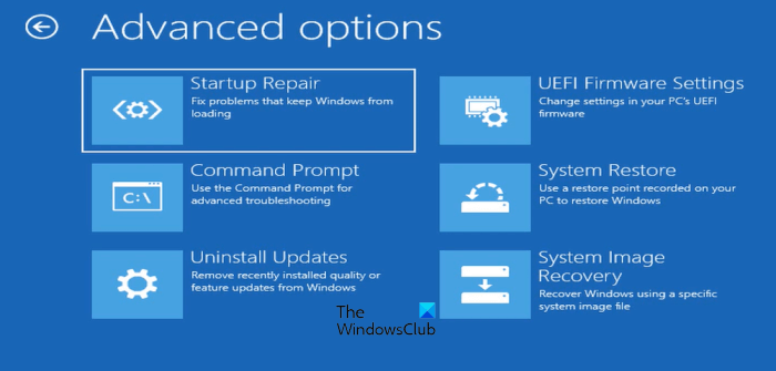

3] Run Startup Repair
The issue might also be occurring due to the corrupted system files. A Startup Repair can fix the problem. To run Startup SRepair, you have to enter the Windows Recovery Environment. If either your keyboard or your mouse is not working, you can enter the Windows RE via Windows 11/10 Settings. But if both the keyboard and mouse are not working in Windows, you can enter the Windows Recovery Environment by interrupting the normal boot process. Follow the steps provided below:
- Press and hold the power button to turn off your computer.
- Press the power button to turn on your computer.
- Immediately press and hold the power button when you see the Windows or manufacturer’s logo.
Repeat the above steps until your PC enters Automatic Repair mode. Now, you are in the Windows Recovery Environment. Now, run Startup Repair.
4] Uninstall Windows Update
Some users reported that this issue started occurring after installing a Windows Update. If either your keyboard or mouse is working, you can easily uninstall the problematic Windows Update via Windows 11/10 Settings. If both the keyboard and the mouse are not working in Windows, you have to use the Windows Recovery Environment to uninstall the recent Windows Update. You can do so by interrupting the normal boot process (we have already talked about this earlier in this article).
On the Automatic Repair screen, select Advanced options > Troubleshoot > Advanced options > Uninstall Updates.

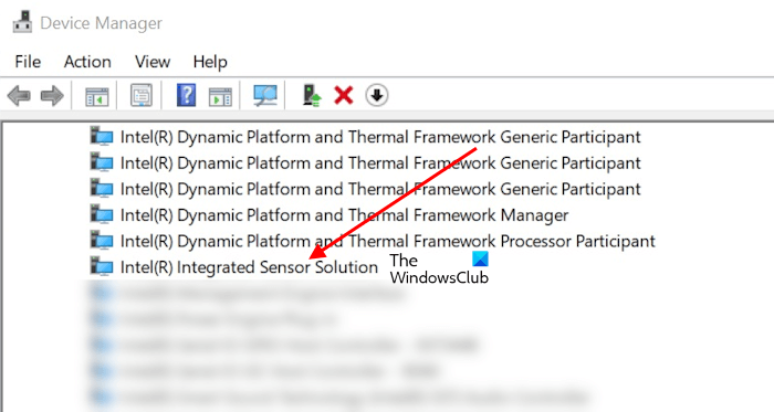

7] Disable the Intel Integrated Sensor Solution driver
The Intel Integrated Sensor Solution Driver regulates the rotation control function of the Gyroscope, Accelerometer, and eCompass sensors in supported devices. According to the reports, some users found it causing this issue. This can be the case with you. You can try disabling it and see if it works. Go through the following instructions:
- Open the Device Manager.
- Expand the System Devices branch.
- Right-click on the Intel Integrated Sensor Solution driver and select Disable device.
- Restart your computer.

9] Perform System Restore
The System Restore will take your system to the previous working state. If none of the above solutions worked for you, System Restore will surely work. You can launch this tool via Windows Search. But if you are not able to login to Windows, you can launch it from Windows Recovery Environment.
Enter the Windows Recovery Environment by interrupting the normal boot process as described earlier in this article. Now, go to Advanced Options > Troubleshoot > Advanced Options > System Restore. Select the restore point before which the problem did not exist.
