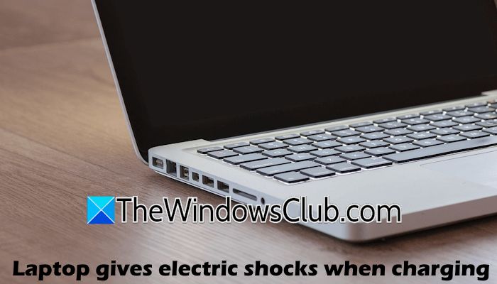

If your Windows laptop gives electric shocks when charging, follow the suggestions provided in this article to troubleshoot and identify the problem. This problem occurs on laptops with a metal body. Grounding issues are the main cause of this problem. Other possible causes of this issue include a bad or faulty charger, incorrect wiring of your house, etc.
Laptop gives electric shocks when charging

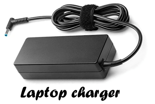

2] Use another charger
Use another charger. If your laptop does not give an electric shock this time, the charger you used is faulty. Replace the charger (if it is under warranty) or purchase a new one. Otherwise, the charger will damage your laptop.
