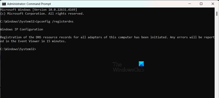

3] Register DNS
Even though your IP address and DNS are two separate entities, we recommend that you register DNS after setting up a static IP. To do so, open the Command Prompt as an administrator and then run the following command.
ipconfig /registerdns
Finally, connect to the network and see if that helps.

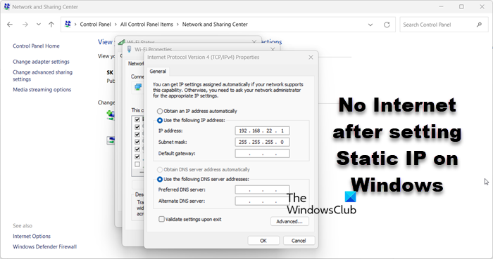

4] Set the DNS along with the IP
After setting up a static IP, you should also configure DNS. The easiest way out would be to set up Google Public DNS. To do so, we recommend you follow the steps mentioned below.
- Open Control Panel.
- Click on Network and Sharing Center.
- Now, click on the hyperlink next to Connections.
- Then, click on Properties.
- Look for Internet Protocol Version 4 (TCP/IPv4), select it, and click on Properties.
- Select Use the following DNS server addresses and then set the following DNS.
Preferred DNS server: 8.8.8.8
Alternate DNS Server: 8.8.4.4 - Click on Ok.
If your organization has a particular DNS Server, use it instead of the Google Public DNS.
