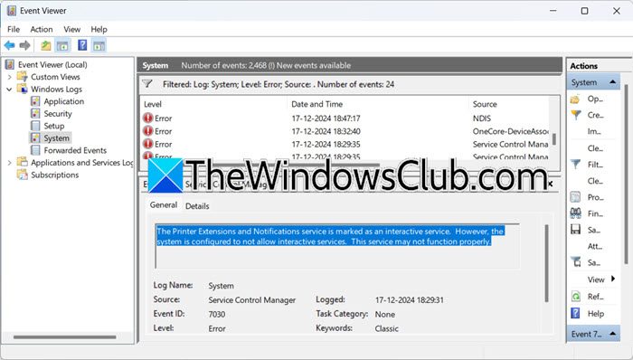

We noticed that a program failed on startup and when investigating further in the Event Viewer, we stumbled upon Event ID 7030. This error can be due to the fact that the service is trying to interact with the desktop which is not allowed as per the system’s settings or the security policy. You will see the exact error message below.
The Printer Extensions and Notifications service is marked as an interactive service. However, the system is configured to not allow interactive services. This service may not function properly.
Log Name: System
Sorce: Service Control Manager
Event ID: 7030

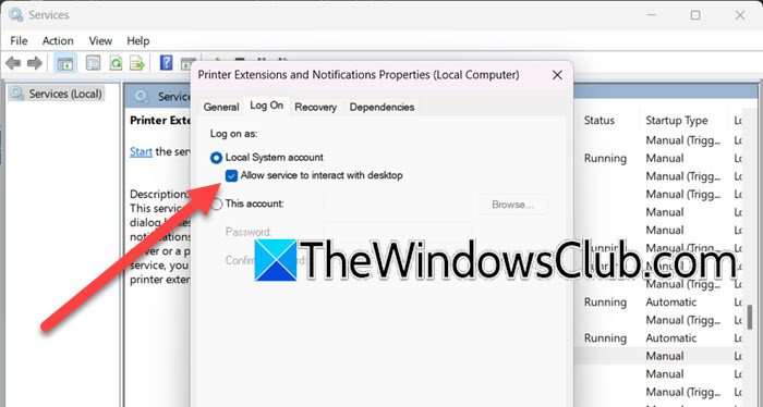

1] Check if the service is marked as interactive
As mentioned in the error message, a service is marked as interactive. This can be any service but according to our error, it was the Printer Extensions and Notifications service. Now that we know the culprit, follow the steps mentioned below.
- Open the Services app by searching it out of the Start Menu.
- Now, look for the Printer Extensions and Notifications service, right-click on it, and select Properties.
- You then have to go to the Log on tab and check if the Allow system to interact with desktop option is checked.
- If it is checked, uncheck it, and then click on Apply > Ok.
Once done, reboot your computer and check if the application is working.
