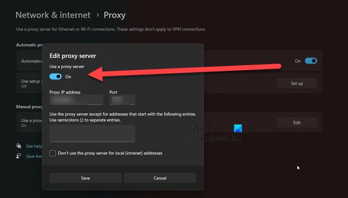

2] Disconnect from Proxy or VPN
A VPN or a Proxy network allows you to connect to different servers. However, when setting up your account, you should avoid connecting to a remote server. If you use a VPN, go ahead and disconnect your network. However, if you are connected to a proxy network, follow the steps mentioned below to confirm and disable it.
- Open Settings by Win + I.
- Navigate to Network & internet > Proxy.
- Check the Use a proxy server, it would be set to On. If that is the case, click on Edit.
- Toggle off the Use a proxy server to disable it and click on Save.
Finally, go ahead and connect to OneDrive.

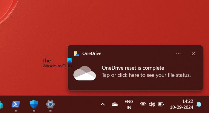

4] Reset OneDrive
Next, we will reset OneDrive to its factory settings. When you reset OneDrive, it disconnects all your sync connections and resets the app to its default settings. This process doesn’t delete your files or data; it forces OneDrive to re-establish connections and perform a full sync.
- Open Run by Win + R.
- Paste
%localappdata%\Microsoft\OneDrive\onedrive.exe /reset
- Click OK.
This will trigger the reset command and you will see a pop-up saying OneDrive is resetting after successful completion of the operation, you will see OneDrive reset is completed pop up.

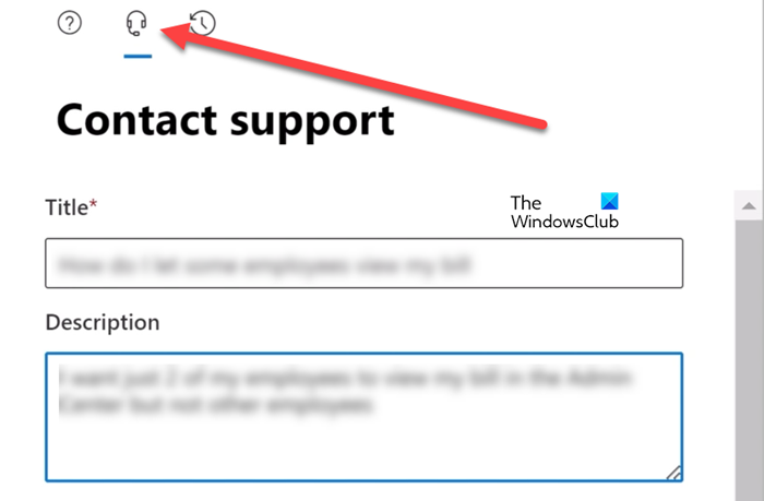

7] Open a ticket with Microsoft
If all else fails, our last resort is to open a case with Microsoft and ask them for a plausible solution. For that, you will have to contact the IT Admin or Microsoft 365 Admin as they can open a ticket from the Admin Center. To do so, one can follow the steps mentioned below.
- Navigate to admin.cloud.microsoft. Only admins can access this page, if you are not one, you will get a message saying the same.
- From the bottom right corner of the screen, click on Help & Support.
- Now, in the search box, enter your concern, and search to find the answer.
- If you can’t find anything, click on the headphone icon.
- Select how you want to be contacted.
- Now, enter your grievance along with the contact information.
- Then, click on Contact me.
You have raised a ticket with Microsoft. They will contact you to rectify your issue.
