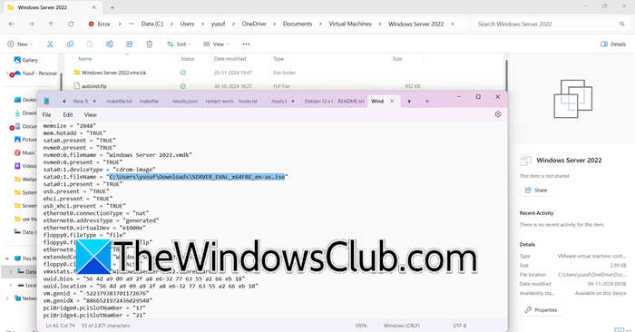

2] Check the VMX path
You need to check the VMX path and make sure that nothing is incorrect, neither the path nor the drive letter. We will check and make the changes accordingly. First of all, open the File Explorer and navigate to C:\Users\<username>\Documents\Virtual Machines. Then, open your virtual machine’s folder and find the VMX file. Open the .vmx file with a text editor and then see if the path mentioned in there is correct or not, usually if you migrate the machine, you will notice an incorrect path. So, make the changes if required and then check if the issue is resolved.

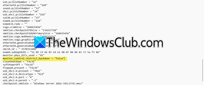

3] Edit the VMX file
We need to check and make sure that monitor_control.restrict_backdoor is set to false in order to allow the virtual machine to bypass certain restrictions that may have caused the issue. The option is used to control the “backdoor” communication channel between the guest and the hypervisor if it’s set to true, the channel is restricted and only allows the guest OS to use the backdoor when the IPOL is greater than or equal to its CPL (Current Privilege Level).
Also, we need to edit the vmci0 entry, which provides fast and efficient communication between the virtual machine and the host operating system, as well as between virtual machines on the same host, we need to set it to false as this feature is known to cause issues.
To make the changes, follow the steps mentioned below.
- Open File Explorer and navigate to C:\Users\<username>\Documents\Virtual Machines.
- Now, double-click and open your virtual machine’s folder, then, look for the VMX file or VMware virtual machine configuration file.
- Open the file in Notepad, look for monitor_control.restrict_backdoor = “true” and then change it to monitor_control.restrict_backdoor = “false”.
- Look for vmci0.present = “true” and change it to vmci0.present = “false”.
Finally, save the file and close it. In case, you can’t find the monitor_control.restrict_backdoor tag, skip this solution. After making the changes, start your virtual machine and see if that helps.
