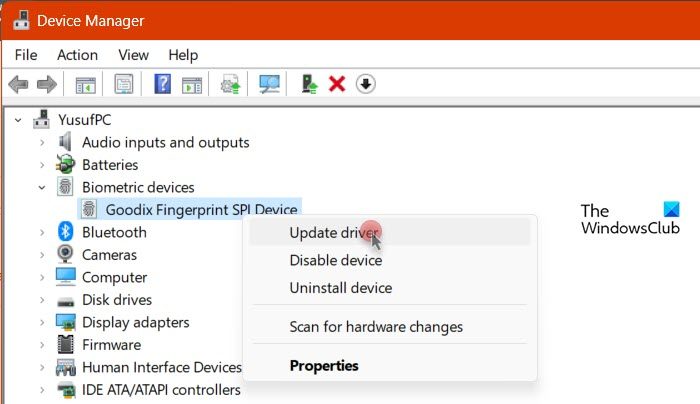

- Open the Device Manager by searching it out of the Start Menu.
- Now, expand the Biometric device.
- Right-click on the fingerprint driver and click on Properties.
- Go to the Drivers tab and then click on Roll Back Driver.

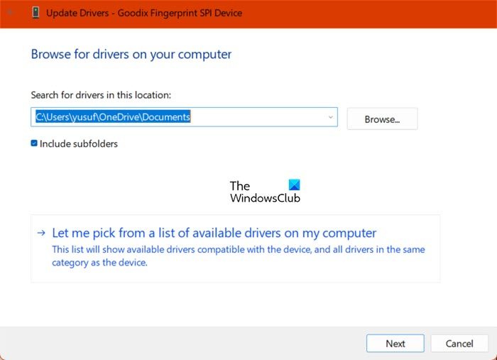

3] Pick a different driver
If there is no update available, you need to pick a different driver if that’s available. Follow the steps mentioned below to do the same.
- Open the Device Manager.
- Expand the Biometric device, right-click on your device, and select Update driver.
- Go to Browse my computer for driver > Let me pick from a list of available drivers on my computer.
- Select an older driver and click on Next.
Finally, check if the issue is resolved

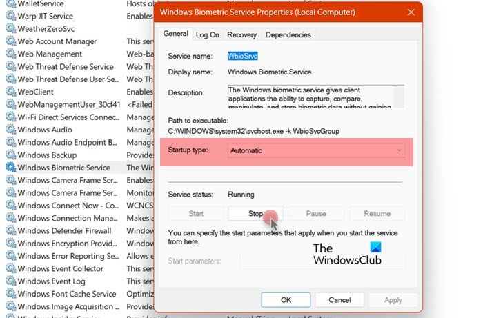

4] Make sure Windows Biometric Service is configured correctly
Next up, we need to check if the Windows Biometric Service is configured such that it starts automatically when your computer boots up. If the service is not running or not set as mentioned earlier, the fingerprint sensor will fail to recognize the input. So, follow the steps mentioned below to configure Windows Biometric Service.
- Open the Services app from the Start Menu.
- Look for Windows Biometric Service.
- Right-click on the service and select Properties.
- Make sure it’s running and the Startup type is set to Automatic.
- Finally, click on Apply > OK.
Now, check if the issue is resolved.
